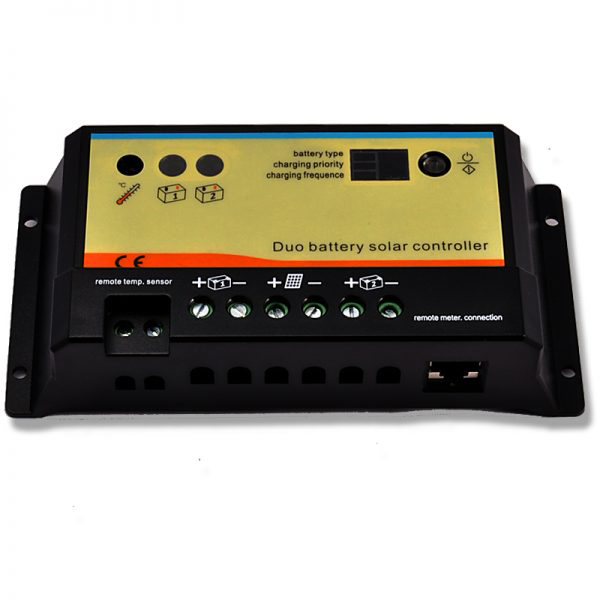

Question 2. Should I connect the solar panel to the same place as the alternator so it can charge both house and starter from each source. Or disconnect the house batteries from the alternator.
