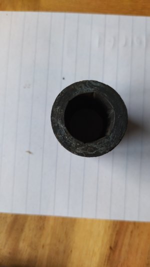

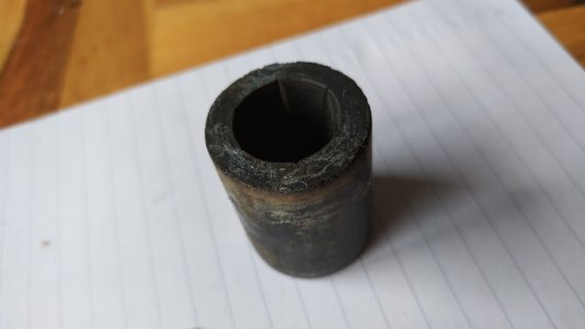

Just remover my cutlass bearing, the boat is long keel with appature for propeller. Prop shaft 3/4” dia I need to get my callipers down to check but (32mm )1 1/4” housing.
Any one ever met this before? Or know where to get one. Great system to remove cutlass bearing, insert small screw driver and rotate it round to brake join and a pair of players it just pulled out. 5 minutes job done.
Now where do I get a new one?

Nobody uses rubber now. Stuart Turner used it in their stern gear bit most people have converted to cutless now and I am not aware of any supplier. The alternative if you don't want a fluted bearing is to have one made of something like Vescomite. However given that it is a standard cutless size can't see any reason not to use one.

This is an old post not but I could not source an all rubber bearing, however I used the laminated paper one phenyl?
