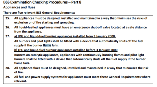

I missed the question but my spirit stoves boats both had a BSS. It wasn’t tested as a party of it.What was the answer to the spirit stove BSS compliance question?
This is what the BSS says

Re reading this and seeing advice given to people on a narrow boat forum as my cooker was installed before the 2000 cut off it may be ok, watch me get the miserable anal bss examiner lolHi M, reference this table, the q was why / how the spirit stove complied with regulation 26…:
Yup. That's OK, satisfies requirement 27.Others will know better, but if the cooker has a thermocouple on each burner, is this the no flame safe?
Edit: if you have to keep the control knob pressed down until enough heat generated to release it
