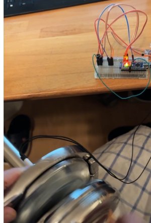

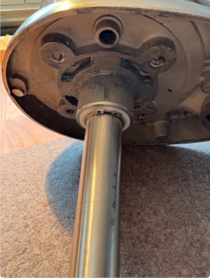

Sorry, I was not really good what I described here. My hubby just told me that he built the chain counter system and used it already. The last weeks in this season, the display didn't show the anchor chain data. He checked the parts, the magnet worked well, so he decided to replace the reed switch, and he found that it costs €99.
@Ian_Edwards yes, you are right, the magnet and reed switch were already fitted in.
After reading your answer my hubby started to find right thing under the search term "Magnetic Sealed Reed Proximity Security System Switch - Normal Open Dia 6mm" immediately. Thank you! He just showed me the windlass and I understood why you wrote the access and drilling is quite hard. You must do extremely precise work on this thick metal If you do it from scratch...
If someone is interested: my hubby used this to transfer data from windlass to display: GitHub - AK-Homberger/ESP8266_AnchorChainControl_WLAN: Remote control for anchor chain that shows current chain lenght via WLAN to phone/tablet (with ESP8266 D1 Mini).
