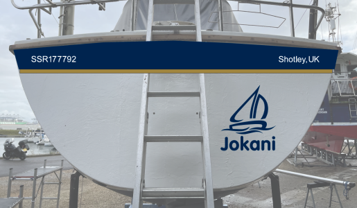

This weekend I will be re-painting the cove line on my aging Westerly.
I will be applying 2 coats of Internation One Up primer and 2 coats of International Toplac Plus, all by roller, and according to the instructions, no tipping is required.
I then intend to apply gold cove line tape immediately underneath it.
Here is a mockup:
I would like some advice/tips on how to complete the job as professionally as possible.
Things I am unsure of:
  1. Putting the masking tape on takes a lot of time so trying to cut this down if possible. - Do I need to remove the masking tape after every coat, before it dries?
  2. I would like to get the gold tape to but up to the blue paint, but I am unsure how best to accomplish that.
Any advice is gratefully received.
TIA

I would remove tape each time, yes.
You could put the tape on first and then mask it, or just get good at applying tape. Generally stick the end on, then unwind about 2 feet of tape in one hand and guide and press flat with the other hand.

Thanks for the advice Lustyd, I think putting the tape on first would likely give a better finish, I wouldn't have thought of that, thanks!

That or you'll get paint on the tape :ROFLMAO: Hope it goes well. Don't forget to tape off the wood strip (I forget every time!) and cut in with a brush before rolling on paint.
Traditionally the cove line is used to hide the wonky paint line so would usually go on last, just like coving and skirting in a house

How are you going to get a roller tight to the wood & get a good even finish if you are not going to tip it off with a brush?
Bearing in mind the narrow width of the band how do you expect to get an even depth of paint with a 4 inch roller if you cannot get multiple passes in various directions to get an even thickness of the product?
Varying thickness promotes runs & promotes different gloss levels.That is why people tend to get a better job with a roller. However, if you do not have the room to manouver the tool then you may not get an even coverage across the width of the strip.
Surely you would be better off with a decent 65 or 75mm brush from the start.
To put the tape on - say 4 inches down from the wood- get a lot of 1 inch pieces of tape & measure 4 inches down. Stick the pieces on at 2 ft centes. Use a lolipop stick marked at 4 inches for a measure.
Then with the main tape start at one end & run along the bottom edge of all the pieces which will give you a very quick guide. You can concentrate on getting the tape on rather than getting the position right as you will have already marked the position. Press the tape down firmly with a cloth. Then remove the marker pieces.

My concern on putting the gold line tape on first and masking over with blue tape would be leakage -don’t you just paint on the blue band and then remove blue masking tape and apply the gold tape ?

Paint first. Pick the right tape, and it doesn't have to come off between coats. I'd be inclined to paint into the cove line a little way, then sand the edge of the paint. That way, an imperfect line won't be visible.
