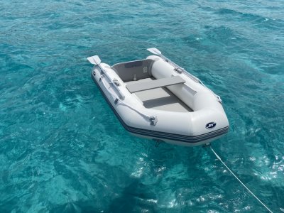

My old flat bottomed tender + my old Porto 35 S Skr ,Limited space etc .
I am majoring on the intended use age identified in the opening post on this thread .Read the Q carefully .

There are zero limitations for the intended use age pattern out lined .Talking from experience hence the pics .Anyhow pics brighten up threads .

I am not justifying my choice it just happens to be ( from the info disclosed thus far ) the identical use age pattern on more / less the same type of boat(s) . The pic s were to show the typical range involved .
