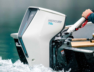

I like the look of the Mercury 7.5, looks like a proper outboard. The thing is that I wish they had designed it to rotate/swing.
Many boats have snap davits on the swim platform and having an outboard that stays on the dinghy rather than removing it every time would be brilliant. Just remove the battery and haul the dinghy up on it's side as the motor stays upright.

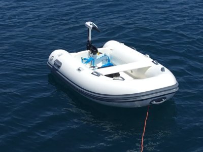

Here’s a pic of mine on the tender .Its so light you can lift it easily with one hand .
Pretty compact for storage off the tender .Under a cockpit seat .
Passerelle acts as a crane for it .
We have had 4 up + dog in this .
