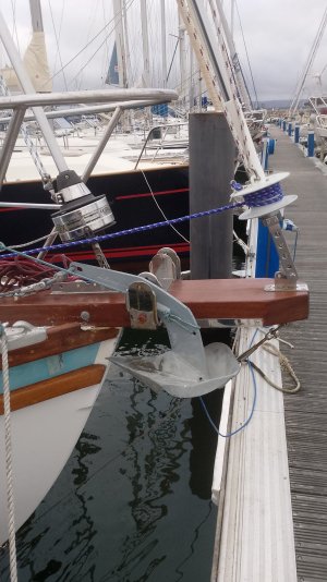

I have just done something similar to put a working jib on an inner and a large genoa on the outer, mostly to be used independently and the genoa for lighter offwind. attachment point is a Selden fitting 30cm below the masthead on a 10m mast, selected to get the 2 stays more or less parallel and maximum hoist for the jib. collecting the new sail this afternoon and putting it on for a trial Friday. Photo shows the lower end

Thank you. It ought to be given it has taken over 2 years from conception to (almost) finish. First endless arguments over parts missing from the furler kit eventually resolved after exchanges with the factory in France. Then discovering more rot than expected under the bowsprit that led to removal and rebuilding the stemhead using some lovely mahogany I inherited from my FIL over 50 years ago. This meant unstepping the mast. Bowsprit got the strip down and revarnish treatment. Then long wait for the rigger to cut down the Furlex to the lower fitting.
The anchor is an Epsilon which is supposed to have the same shank geometry as a Delta or CQR, but I went down a size (because it is more efficient!). so it does not self stow and solution is to fit a chain stopper to bring the chain and shank down to deck level and the fluke will touch the stainless strip I added to the underneath of the bowsprit.
Never a dull moment.
