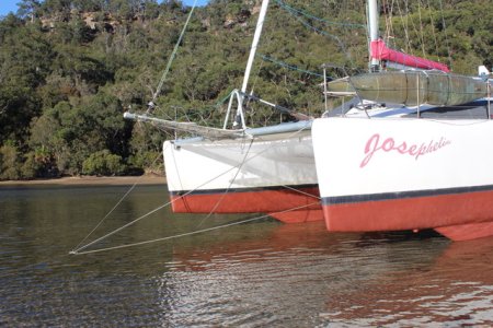

We did what you intend regularly on Josepheline, its easier but takes longer on a multihull. Our tides are a bit parsimonious at only 2m, and we draw 1m. The water might be warmer - but we still wore chest high waders. We would start wiping once the stem was clear of the water.

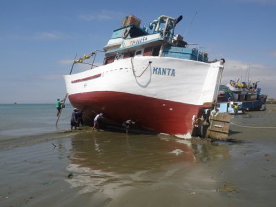

In Manta the the tuna fisherman do the whole thing between tides, including the AF itself, in this case Hempel's Olympic. They are actually applying the AF as the tide comes in.
