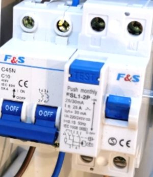

Yes, actually I have changed them. These are in place now.
What do you say the potential issue with the RCD was?
The original RCD just looks old, they don't last forever.
The MCB you fitted is only 10A, a standard kettle will trip that.
Despite being asked 3 times you still haven't said what type/size the cables are. It's difficult and dangerous to give detailed advice without having all of the facts.
I am a bit confused by the latest pics. of the Consumer unit. I think that perhaps the best thing is to seek local professional advice. Like Paul. I am very reluctant to offer advice on what I have seen. I should say that from what I have read F&S units are somewhat unreliable.

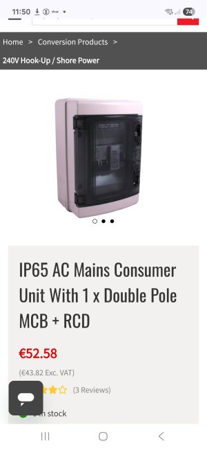

If the consumer unit is suspect I may replace with one of these from 12volt planet.
Paul has asked repeatedly for info on the original question, which you haven't provided:cry: We can't give definitive answers to mains voltage installations without a lot of info, In fact I am averse to giving advice in many cases purely on the grounds of safety.
There maybe nothing wrong with your consumer unit the devices you have will work. What I was trying to say, was that, the make you fitted is, from what I understand low quality chinese and prone to failure.
What I am also trying to say is that the picture in #12 does not show the configuration of the Unit. It is unclear.
If I had to fit up a consumer unit, I would have an incoming 16 amp MCB and a 16 amp RCD (Probably 2 pole) or a combined MCB/RCD (RCBO) something like this. https://www.screwfix.com/p/british-...-c-curve-bidirectional-rcbo-double-pole/911yc Note type A.
I would then have a 16 amp SP MCB for the power (Sockets) and a 6 amp for lighting. As a minimum. You don't need more than 16 amp breakers as that is standard supply in most marinas.
