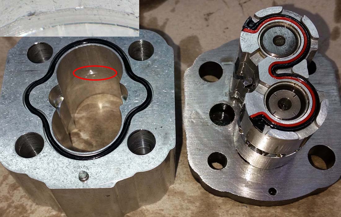

Long story short, below is the pump body opened.
The bad news is that according to a pump specialist, the groove which is highlighted in the pic was formed by the inner gear, possibly due to running dry, and that is enough to make the pump cavitate, without building up any pressure.
The same chap suggested that the external body alone is not available as a spare part, hence the pump should be replaced.
Now, aside from not understanding how and when the pump ran dry, considering that the oil level has always been close to the max, I would be curious to hear if anyone more knowledgeable than myself on these components (i.e., probably most forumites!) agree on this diagnosis.

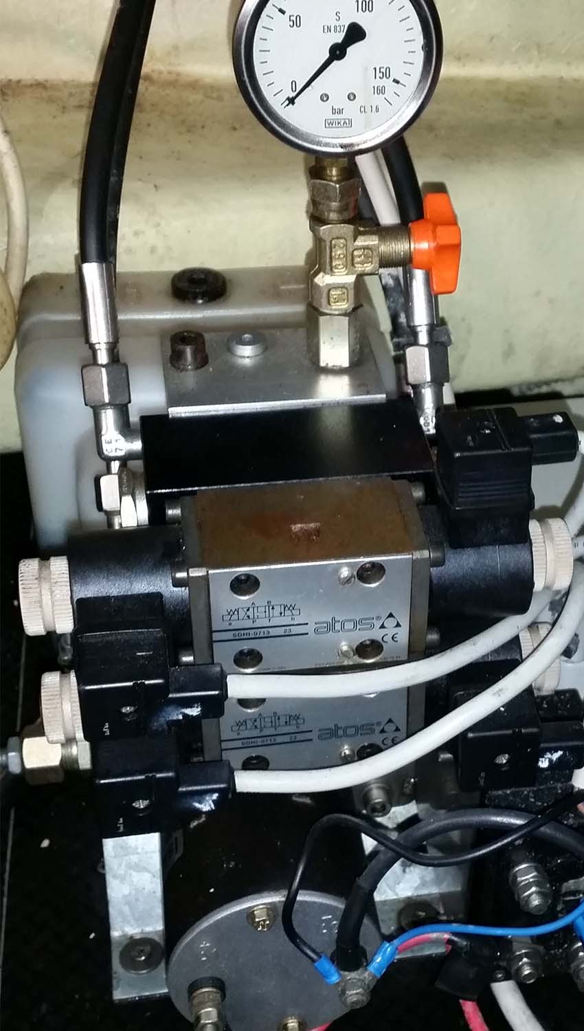

And if so, also any suggestion on suppliers of these things would be most welcome, since it would be silly to replace the whole controlling unit, with its motor, valves, etc. - I am attaching also a pic of it, just for reference.
based on my experience with my port g/box not building up pressure for engaging the forward disks, a similar groove (if not smaller) was to blame.
So yes, I agree with the diagnosis :(
no suggestion on a solution though, first time I see a twin cylinder like that...

Thanks everybody, it's interesting to learn that these oil pumps can be so sensitive to wear.
That's what I was more curious about, because I was fearing that the fault might actually be elsewhere.
I don't think that repairing the existing body would be much more cost effective, anyhow.
After all, in spite of the thread title, I believe/hope it's far from being a matter of another thousand, also for a new pump.
So, I think a replacement is the way to go, though I'm still in doubt about the possible reasons for such wear.
I'm going to replace the oil in the circuit while I am at it, but other than that, I can't see what else I could do in the future as preventative maintenance... :confused:

Who is the manufacturer of the pump, is it marked on the outside?
A goodly number of such pumps are made by your countrymen (IT)
The only recognizable stamp on the pump body says "RIVA", which obviously has nothing to see with the Aquarama builder.
I would think that it might come from Riva Calzoni, but at the end of the day I guess it's just a matter of finding a replacement with similar specs and dimensions that can fit in the rest of the controlling unit...

Just a quick update in case anyone might be interested, and for future reference.
Today a shop dealing with industrial oleodynamic components confirmed me that in the pump range of this producer there is a model which is 100% interchangeable with mine, available at 150 quid or so.
Which makes any repair possibilities not really worth exploring, I reckon...

Try also pumps from Casappa, also IT manufacture. We have used them for many years on forklift trucks . I suspect that the body will be vv similar or interchangeable. It is, after all, an aluminium block machined to take a pretty standard pair of rotors

I'm resurrecting this thread to report about the happy ending.
The problem was actually solved, with the pump replacement, already several weeks ago.
Yet another case of the forum working its magic, I must say: tico not only has been extremely helpful with the identification of the pump specs, but eventually also sourced a compatible replacement and sent it to me.
Saying that he impressed me would be an understatement, thanks a lot for everything!
The reason why I'm following up only now is that due to some last minute inconveniences, I've only been able to make a proper test yesterday, during the transfer of the boat from my usual yard to CF. And the new pump works beautifully!
Gut feeling tells me that the flaps now also move a tad faster than before, btw.
I guess that's either due to a tad higher power of the new pump vs. the original one, or to the fact that the old one was already beginning to wear out when I bought the boat. Impossible to tell for sure, but the equipment is now as good as new, which is what really matters.
