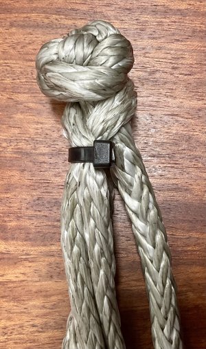

Among my many nerdy interests are how best to make and use a clutch of soft shackles. A question was raised. I thought to raise it also here...
Some have expressed concern that the end-loop can slide open when cyclically unloaded, and slip off the GreatBigKnot it's fastened around. Looking for a cheap 'n cheerful answer, I mused that the quite stiff - and slightly overlength - antichafe sleeve might suffice.
But what, I thought, if the sleeve became floppy with flapping? More restraint might be needed. A job, methinks, for very cheap/cheerful reusable cable ties.
( sleeve removed for clarity )
Cable ties could be fiddly, with cold wet fingers on a stormy night hanging over the side. What might a hoary old master mariner or a Boy Sprout of yesteryear have done?

This innovation with soft shackles in particular, and Dyneema in general is great to see. These are relatively new products and I think you are going to see some significant improvements in the near future.
A few comments from wife who is much more in tune with nuances of this rope work:
Soft shackles very rarely come undone. We have never had one inadvertently release and we use many of these in conditions where there are cyclic loads such as the chain to snubber connection and headsail sheet attachment. However, anything is possible so for a particularly critical load there is nothing wrong some extra security for complete peace of mind, but this will only be very rarely justified.
The idea of a sheetbend is a good one, but there is some risk of this jamming under load in this situation.
If using a cable tie it should be placed on the narrowest part at the base of the eye where the crossover occurs (see photo below). Placing the cable tie as shown in post#1 narrows the throat angle and may potentially weaken the soft shackle.
Keep up the good work.
