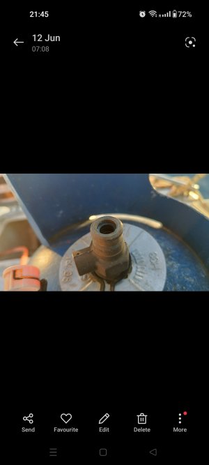

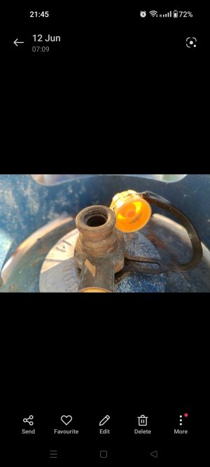

Recently I had the bottles refilled in Nuku Hiva, French Polynesia and now when I attach the regulator, gas escapes from the cylindrical seal in the top of the bottle. The top of the seal appears to be around 0.5mm lower (photo with yellow cap) than the one in the good bottle (photo without cap). It almost seals but not quite.
1. Is there a way to resolve this without sourcing a new seal? Maybe an additional O ring?
2. If not can I source a new seal and have it shipped from the UK?

The problem is likely to be in the clip-on adapter or regulator. The good news is that these are typically serviceable, whereas a cylinder probably isn't.
1. what size clip-on?
2. when did you buy it (6 year life, possibly less, whereas gas bottles need servicing only after 15 years)

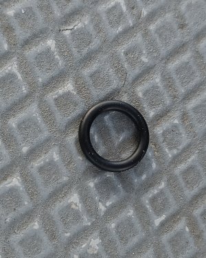

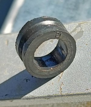

That did the trick. Thanks. Perfect seal, no leaks.
First Image: Original seal carefully removed.
Second Image: O ring inserted beneath original seal.
