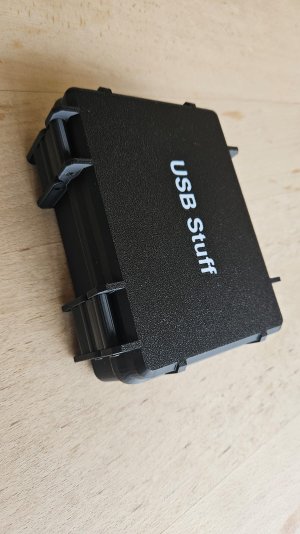

And this is the lid of a box lid I made from a parametric design to hold all my USB nicknacks
This is the finished job
