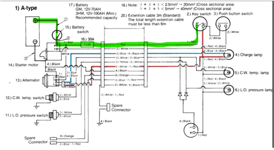

To be honest it doesn't sound like it is the earth from the symptoms but it is worth checking anyway as they do corrode away and aren't easily visible. Usually with earth strap corrosion you would have starting trouble (slow turn over or clicking from the solenoid) before you noticed other electrical bits not working. I'm betting it is something to do with the in line fuse holder but making and breaking every connection is pretty much guaranteed to either fix the problem or reveal the issue.
This is the first wire to check imo:

I owe you all a beer!
It was the fuse holder. I turned the buzzer on and shook the fuse holder and the buzzer became intermittent. Took it all apart, cleaned with contact cleaner and sand paper. Now totally fine.
