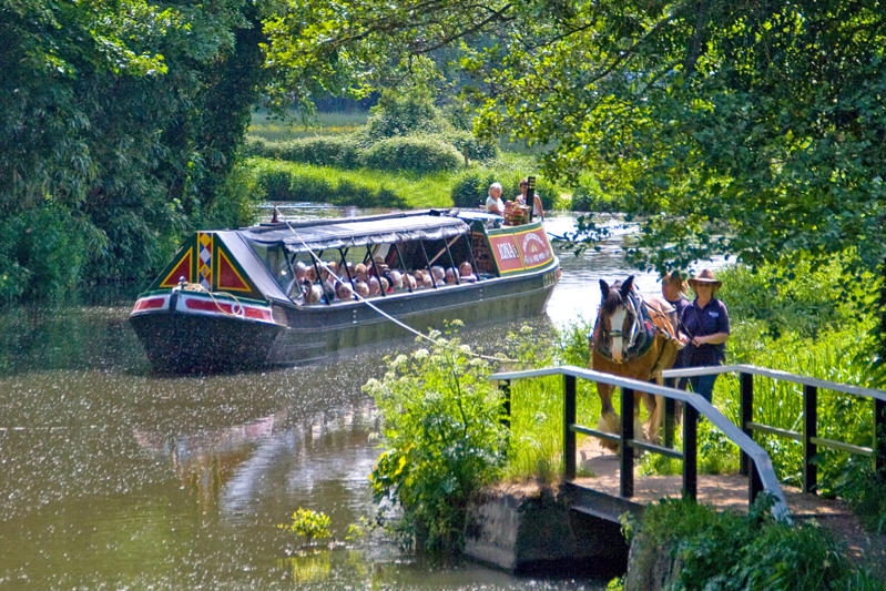

If you tie the tow rope at about 1/3 of the length from the bow towing a boat will tend to tow straight parallel to the tow canal side i the came way as horse used to tow narrow boats along the canal
