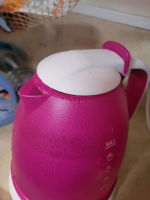

We have gone the other way. Inverter and small 0.8L Argos kettle, now £20. Takes 4 minutes and 15 seconds to boil 0.5L which makes two mugs of tea. This and a single induction hob halved our gas usage. Interestingly the kettle seems quite stable just sitting on the galley counter, even sailing to windward.
