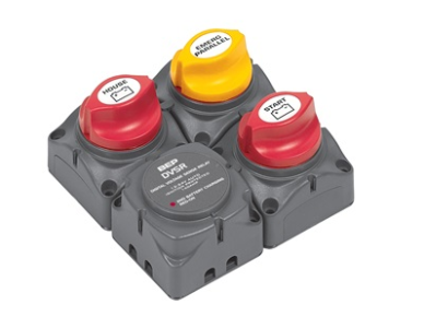

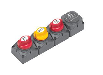

A neat solution is to use one of the BEP switch clusters consisting of two isolation switches, an emergency paralleling switch and a VSR
Two versions to choose from but if you opt for one of these ask here again for instructions on reconfiguring it so that the emergency paralleling switch parallels the loads not the batteries.

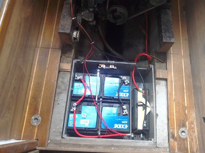

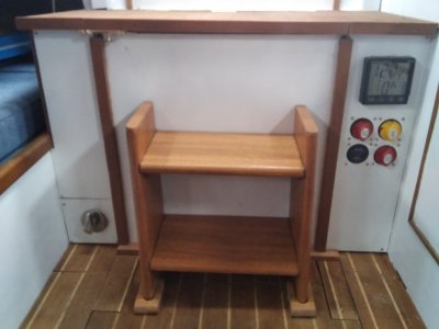

Why do you think that might happen at all with such a simple system? I first installed a BEP switch cluster in the mid 1990s on a simple boat like yours appears to be - one small start battery, one house battery and a Yanmar 1GM (no solar in those days). No problems over the next 20 odd years. Same system on a bigger Bavaria 37 and now on a Golden Hind 31. The only negative is that the emergency switch parallels the 2 banks rather than just switching the house to the start circuit, but as I have never needed it probably irrelevant.
If you keep the 2 banks separate and match your house bank capacity to your usage pattern plus keeping the house bank fully charged when you are not using the boat (with solar or shorepower) you don't need any of that fancy stuff.
As an aside, but related, consider using an AGM for the house bank as not only do they have higher acceptance rates but low self discharge. Typically 30% more expensive than leisure batteries, but easily 50% longer life. The photo shows my latest setup with 2*95Ah stop start automotive AGMs chosen partly because I had them in my last boat but mainly because they fit the space being lower than most. The start is an Odyssey AGM, very expensive but the only type which fits the space. If I had more space it would be a simple diesel car battery around 60Ah. Engine is a Beta 30 with a 75A alternator. No solar as I have shorepower. BM1 battery monitor more than adequate to keep an eye on charge rates and SOC. The photo of the batteries was taken before the wiring was completed, just enough connected to run the new engine.
