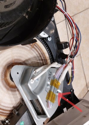

I have a Meaco dd8l Zambezi. It is completely dead! I have dismantled the entire thing to about as far as you can go! I have checked power at each end of the 4 thermal fuses located in the 'pie slice' shaped piece, and the temp sensors (small glass looking bits) next to them, and all seem to show consistent readings when the dehumidifier is plugged in. I need to check the small fuse on the circuit board still, but does anybody know of anything else I should be checking before I declare the thing knackered? I'm no expert in electrical components but I'm willing to give it a go! perhaps a new board is needed? It is very clean inside and everything looks in good condition which leads me to believe it must be a fuse or something simple which is causing the whole unit to be dead.

Hiya, did you find/repair the fuses? Are they these on the heater?
yes i found them all.
checked them all, two on the outside, two on the inside, voltage was consistent at each end of each fuse!
