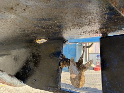

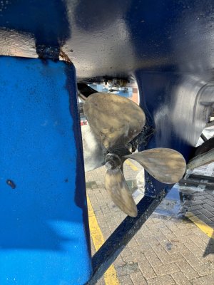

Sadly the lift out and bottom clean didnt have any major effect on the engine performance.
We've gone from maxing out at 2350RPM to 2600RPM.

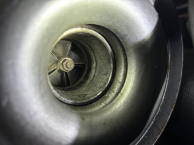

I took the air filter off and hand a look and poke at the turbo. I couldn't move the blades with my fingers - is that correct? No movement as far as I could tell in the turn shaft.
j24jam
17 Jul 2011
266
You should easily be able to spin the blades in a turbo by hand.
Ok, thats interesting... seeing if a friend can go have another go after work to save me a trip back to the boat... I may have been doing something wrong.
If they dont spin, is that turbo out for refurb or something else that may be causing it not to spin?

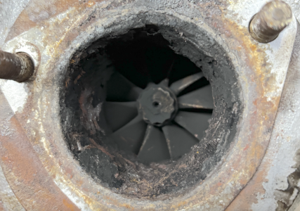

Finally got the turbo off. It's very seized.
See all the crud on the exhaust side. The flaking bits appear to be a mix of soot and rusted turbo housing. Not sure if that is a big issue or not?
Dominicpriestley
20 Jul 2014
17
The recon people will tell you if it is. Mine had some pitting when it was all cleaned up, but they were both still good enough for a recon.
