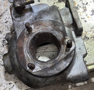

It looks like you have been running your engine on heavy bunker fuel and not on diesel!Finally got the turbo off. It's very seized.
See all the crud on the exhaust side. The flaking bits appear to be a mix of soot and rusted turbo housing. Not sure if that is a big issue or not?
Thank you. Good to know. Will be speaking to a turbo specialist tomorrowYes it can be done, depending on the company you use for the recon work.
