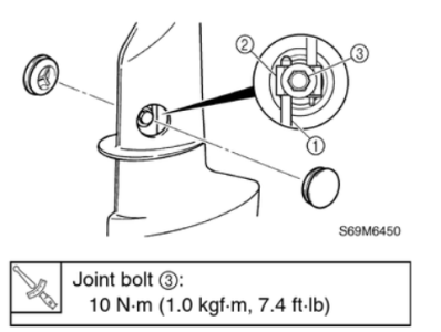

Check the joint between the upper and lower shift rods. Should look like this.
Make sure that the lower rod moves ( down to select neutral) when the shift lever is moved.
If necessary slacken the clamp bolt, push the lower rod down to put the gears in neutral, check that the prop will rotate freely without turning the engine and with the shift lever in the neutral position tighten the clamp bolt to 10Nm

Thanks for your help and the picture ,
I did have a look at this part but looks fine with engine off shaft does move up and down as expected also bolt tight.
