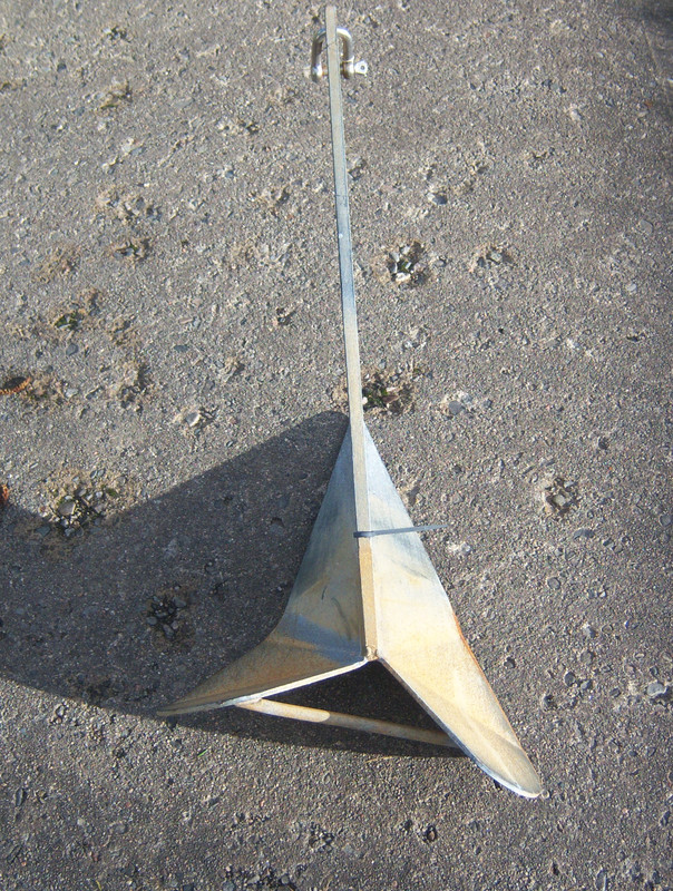

If you can check out this article Anchor Tests: Bending More Shanks - Practical Sailor look at the damage caused to the aluminium Excel.
The aluminium Excel is a direct copy of the steel Excel except that the aluminium version now has a more beefy shank, made from 7075 aluminium which has a lower tensile strength than the 800 MPa of the steel anchor.
But to cause the damage done to the fluke then when the snatch load was applied the fluke held tenaciously - if the hold had been low the anchor would simply have popped out and no damage would have been done.
Its a credit to the design - but not to the engineering. The level of destruction was a real eye opener, totally unexpected.
The aluminium Excel was completely rebuilt for the necessary strength, inclucing the upgrade to the shank. WE had one of the original alluminium versions, this is (or was) it. We were given a new replacement to the upgraded engineering (and have now been using it for years) but we were requested to bequeath the destroyed version to AnchorRight - but we took the pictures prior to releasing it.

This anchor has both a low hold and is poorly engineered but enjoys much support - good marketing (beware the hype) and excellent customer service wins. (I do have other pictures - its not an exception). Holding capacity (including magazine tests) and Proof Testing are good criteria.
BUT - you can bend any anchor if you try hard enough. I have pictures of bent anchors, including those classified as SHHP, - it is possible. You are simply hedging you bets if your anchor has been tested

Not entirely true - in the bendy shank saga I was given a an anchor whose anchor was tested (by a NATA certificated testing facility, that had bent in a sudden wind shift during a thunderstorm in the Caribbean. The owners were most unlucky - they must have had one of the early suspect anchors sourced in Europe, which bent, it was replaced in America with another suspect anchor - which also bent. Of the few reports of bent anchors - it was the shank that bent, commonly during retrieval. In fact of the bendy shank episode - there were only reports of bent shanks. There are images of bent flukes - some have bent, like the one I posted, Post No 23, where the fluke has bent because the fluke lacks robustness and/or has bent at a poorly located and executed weld.
