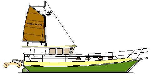

It used to be commonplace to see displacement motor cruisers fitted with a smallish mast aft, carrying a 'steadying sail', cut flat and sheeted on the centreline. This - presumably - acted as air-brake to reduce rolling.
