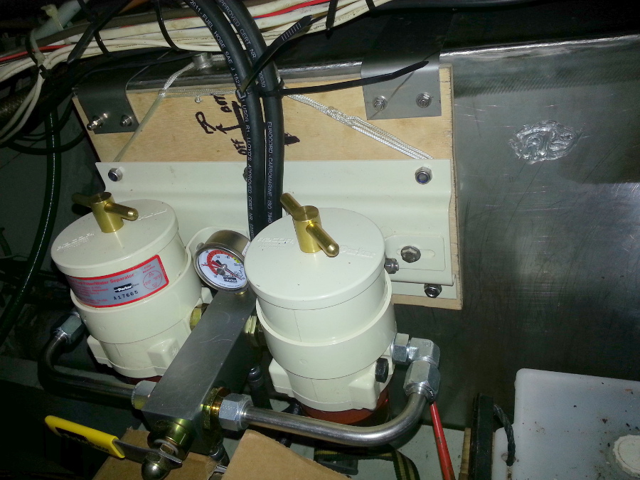

I asked the same question a while ago and it lead me to learn of the existence of CT1. I used it to bond a plywood panel to the side of my stainless fuel tank, onto which I mounted a new fuel filter system. I did also add straps over the top of the tank. I used the clear CT1 option and put a sample blob on the tank next to the installation. You can see panel, blob and straps in the picture below. It was installed 2 years ago now. Still solid as a rock. All I did was clean the steel with some thinners and a cloth.
