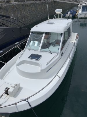

After some information on replacement windscreen wiper motors/kits for a 2001 Antares 760
Are they still available or are there aftermarket replacements TIA Leon.
any useful information happily received 😎👍
