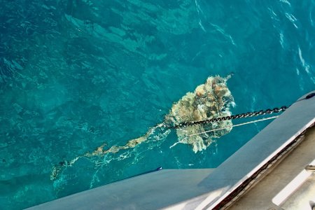

AgreedThe windlass for a long distance cruising boat should ideally be specified such that it has plenty of reserve power. On occasions, it will be called upon to retrieve not only the normal anchor and chain but debris such as the corral encrusted steel rudder and stock from a shipwreck pictured below that we picked up in Barbados.
More commonly, crossed anchors mean that you need to retrieve not only your own anchor and chain but that of your neighbour.
