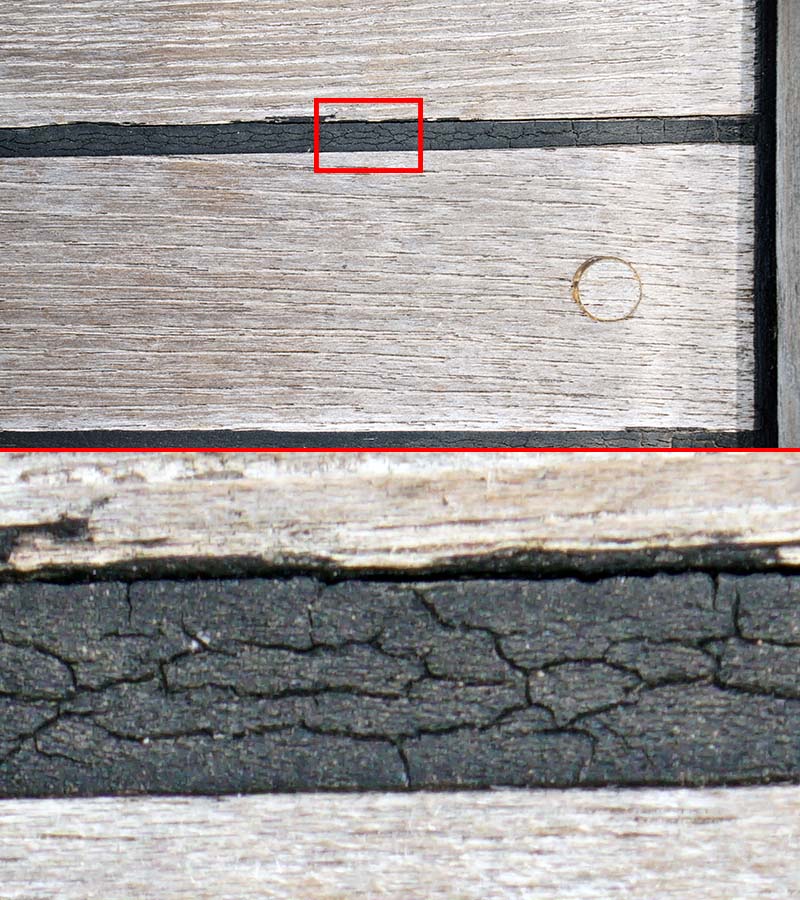

A small warning on Sika.
A couple of years ago, I showed in this thread how badly the recaulking of my deck, made by a professional yard with the 290i DC, deteriorated after just a couple of season.
The pic I posted back then is not visible anymore in that thread due to the Photobucket crooks, but here it is:
Anyway, just for the records, it was afterwards confirmed and recognized by Sika that the problem was somehow connected with the formulation change introduced with the "i" version of their stuff - to the point that they refunded my yard (not just the material) for another full recaulking job.
Now, I don't know if this trouble with "i" formulations, whatever it was, affected also other products.
And it might well have been fixed in the meantime, I suppose.
But as the old saying goes, once bitten, twice shy...
