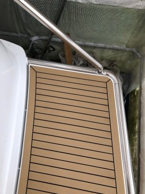

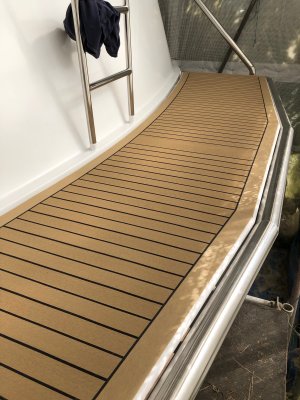

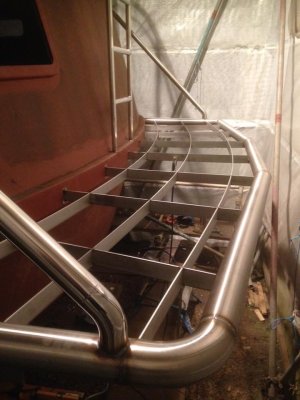

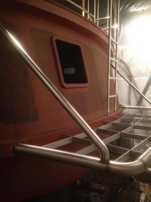

Maybe consider hygienic fittings and tube. This is a thin wall tube for which you can purchase a range of fittings including bends etc. which can be bought polished. It is butt welded using TIG but you could prepare all the cuts/joints etc, then get someone to weld them up for you. Each of the welds would then need an acid pickle and a final polish on a buffing wheel.

I used this type of approach for the perimeter frame and supports for my swim platform
Looks very nice.
