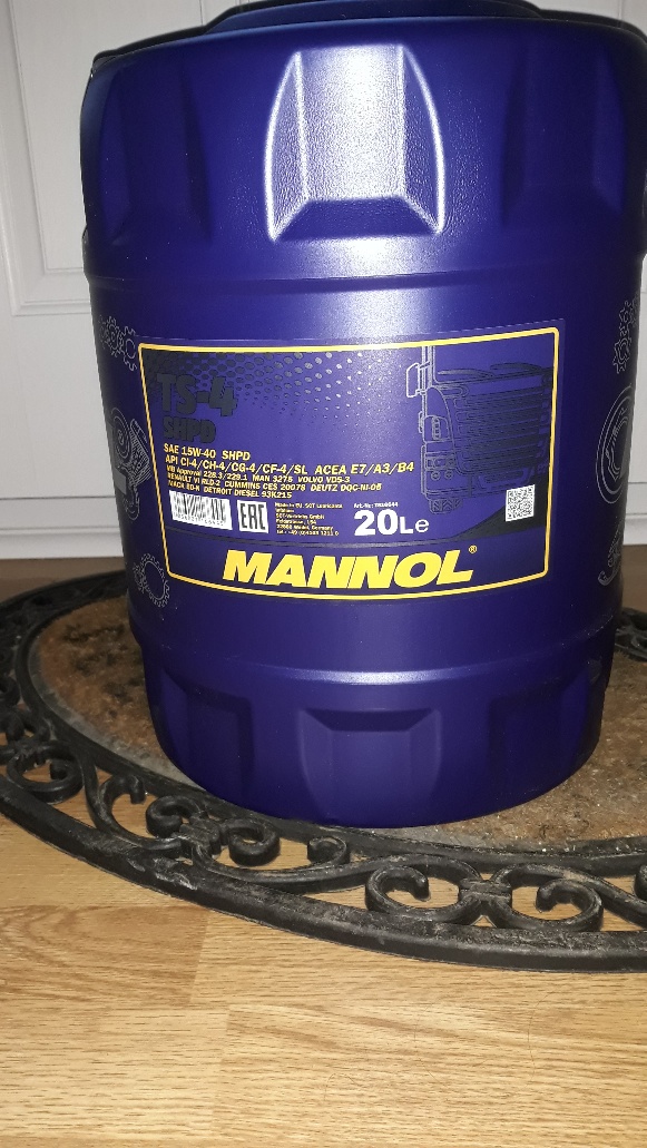

20 litres of vds3 engine oil arrived this morning at 8am (Thursday) . Ordered on Tuesday afternoon .
£38.26 all in, including delivery, which is good value .
Supplied by
lubriagecarpartsaccessories on eBay
.... No connection just a customer

The Mannol oil is now in my engines - looks and smells like any other oil (no surprise there).
The tub has no pull out spout and no breather like some so makes pouring the oil tricky (a little spillage) until part way down the tub - but that's a minor thing.

The Mannol oil is always available too - the price goes up and down a bit with different offers (that seems to be an ebay marketing thing). In my case I always have a couple of litres of oil left over out of the 20L but the engines don't consume any oil. So I flush the remains of the saved oil through the engine at each oil change.
