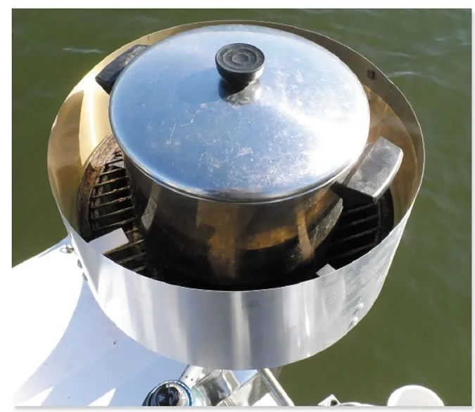

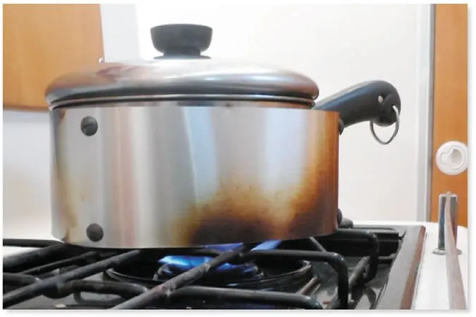

A propane hob can also be made ~ 20% more efficient by adding a pot skirt. Even more effective on the grill (my wife makes me steam crabs outside because the onions and seasonings). The efficiency gain in the wind is even greater.
