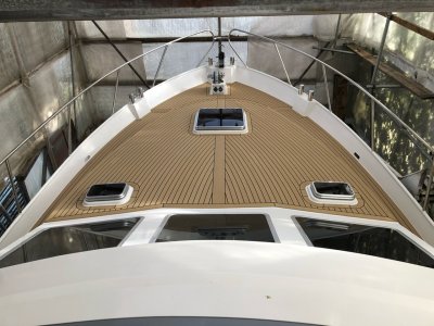

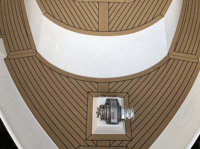

When I started on the foredeck, I spent a long time deciding whether to make snapes out of plastic.
Making snapes is time consuming and for a DIYer can look awful.

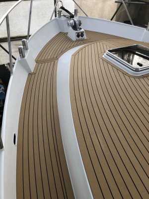

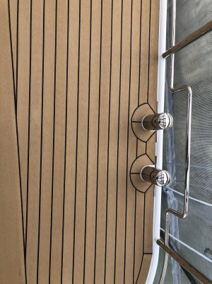

So I did some tests on my foredeck to see what I preferred.
I took some photos

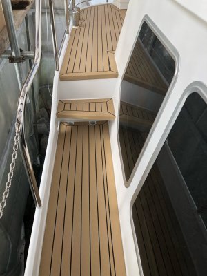

The side deck specifically.

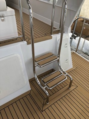

This is with homemade DIY snapes

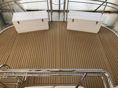

And this simpler design
Taking it all into consideration, we went with the simpler "cleaner" design.
It isn't authentic - but, then again plastic teak isn't authentic anyway.
And this was the final result - a clean, uncluttered design.

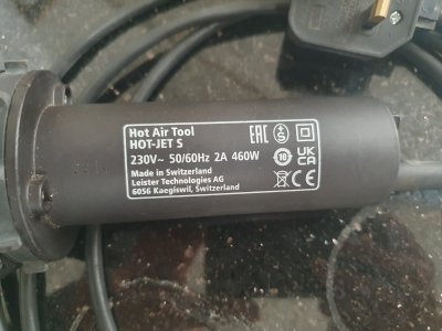

Don't cut corners on the welder.
As I said above, I regret buying the Steinel welder.
The Leister Hot Jet S is the one to get.
Maybe pay a bit more and sell it on after - I'm going to keep mine.
