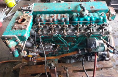

Hi Everybody.
I’ve been looking at a 1976 Fairline Phantom 32 with these Volvo Penta engines fitted.
What are they?
They are connected to a pair of outdrives.
Am I correct to assume that these engines are obsolete now and there’s no parts available anymore making the boat worthless.
Tbs Penton hook are trying to get £20k for the boat.
Many thanks
Edited: as below, AQD32
Service parts like filters and belts might still be available, many other parts most likely not.
But .. do they start and run smoothly without smoke or excessive crankcase pressure?
Is the coolant nice and clean?
Oil okay?
Outdrives?
What about the condition of the rest of the boat?
A drivetrain doesn't have zero value if it is still running well.
At a guess 6 cylinder diesel from counting the injectors. ????
Good supplies of budget aftermarket servicing spares for those engines which never actually wear out but usually meet their end due failures in cooling systems etc because of neglect.
Would be more concerned with the outdrives of that vintage but again loads of spares and secondhand bits around.
Get somebody who knows about outdrives to have look.
If previous owners have loved and maintained that boat, there could be still years of life left, it would need to be purchased at the right price.
A receipt from a known reputable marine service company regards a recent service ( not two years ago) on outdrives would be a boon.
We do have a Sedan 32 on our moorings , skipper claims he can get approaching 30 knots on good day, the less said about his outdrives the better. :)

This boat has the same engine described as
Volvo Penta ADQ32 6 Cyl Diesels .
Princess 33 1979 Used Boat for Sale in Lancashire, United Kingdom
was the 32 not a 4 cylinder ?
Engine AQD32A
Production period 1969-1977
Operation 4-stroke
Cylinder configuration 6
Bore (mm) 90
Stroke (mm) 83
Compression ratio 22.1:1
Displacement (litres) 3.17
Power (hp) 106
Max engine speed (rpm) 4000
Engine AQD32A
Operation 4-stroke
Bore (mm) 90
Stroke (mm) 83
Power (hp) 106

AQAD32 ... parts are not readily available ... Family friends bought same boat new with same engines in 1977 ... lasted a couple of years, weak cylinder head seal and boat did struggle to get up on the plane if you had anything heavy, such as a dinghy, near the stern... 12-13 knot cruise when new and around 17-18 knot max... Engines ripped out after second warped top and replaced with 40A's at 130Hp, which transformed the boat ... 40B's and duo props would be even better... by all means consider the boat, but do not put any value on engines...
Volvo Penta TMD40A 136hp Marine Engine used for sale - Boat Engine Inboard in Dorset, United Kingdom | Youboat UK
Oops, regards spares was thinking it had "40" series engines. Need to be careful regards both outdrives and engines ?
There are Princess 33 on the market with shafts for not that much more money
These are originally Puegot engines, their weakness is the water jacket around the exhaust manifold. Its corrodes through and lets seawater run into the cylinders.
