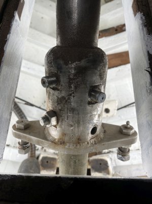

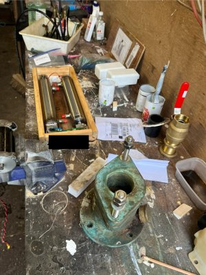

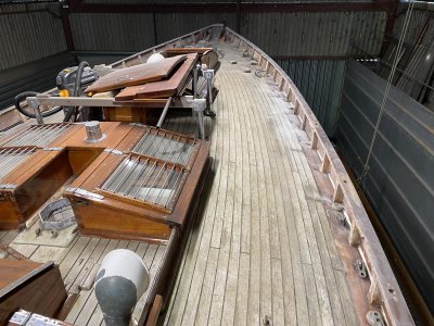

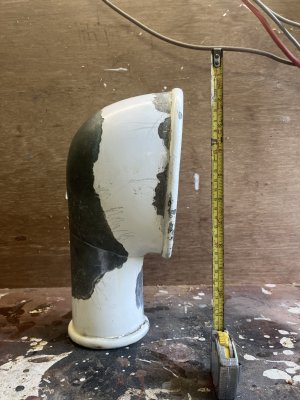

I'm trying to maintain a 1947 teak on oak cutter, It's now been ashore for 15 months. Insides stripped out to check all floors and frames, some removed and replaced, about 100 new bolts, All repainted. A few keel bolts out and one replaced.
Old chrome being re-chromed, some new bits of structural timber, mostly I put the works on FB. "yacht croix des gardes"

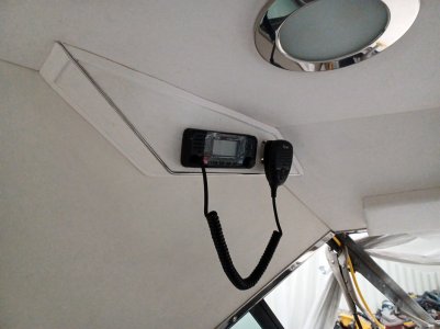

Here's a small project as part of the greater scheme. I don't like gear hanging on brackets so I made this simple pod for the VHF. It consists of 6mm ply encapsulated on all sides with resin and tissue and bonded together with mat and resin. Then covered with vinyl flooring (my covering of choice) with the corner trim from a length of 5mm polished stainless rod bonded on with CT1. I'm quite pleased with it.
Perhaps we need a new section on projects where we can show what we are doing without feeling embarrassed.
Well smart 👍
