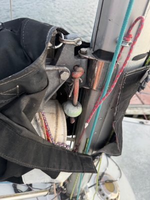

Hi can anyone help I have 2 large Rope Stopper Balls on my boom at the Boom bracket section I think it’s something to do with a reefing system but I’m guessing?
25 foot projection 762

Looks like there should be a rams horn in the hole where the clackers are. (imagine kenneth Williams saying that🤣)
Agree with others - probably to do with reefing. Actually quite a good system, compared to ‘rams horns’, I reckon. All you need on tack reefing cringles is a looped line that just fits over ball - less likely to fall off than equivalent rams horn set up.

I have a short length of clear hose pushed on from one rams horn to the other underneath the boom, to stop the spectacles falling off the horns if I lose tension before hardening back up. If they do sag, the hose leads them back onto the horns when I pull up.
Maybe the idea is to pass a loop of the red rope through the spectacle ring on the sail then pass the white ball through the loop. But the red rope looks a bit short for that.
Other end that we cant see may have an elongated loop on it to go through the ring and then hook onto this ball.
