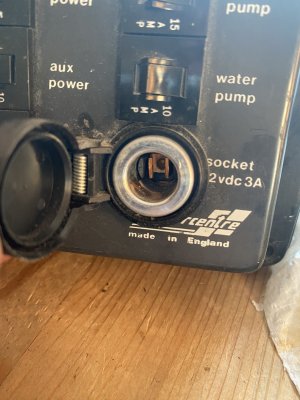

I have this 12v outlet on my MAB and wondered what sort of plug goes in it. It’s smaller than a cigarette lighter socket and an actually look far better made as well. I’ve tried googling, but I’m getting no where. Is there a name for the plug that fits this? Thanks

It looks like a DIN (or sometimes called merit) socket.
These are a popular "improved" cigarette lighter socket/plug that will handle a high current more reliably and with less heat. Some DIN sockets are designed to accept both a DIN and a cigarette lighter plug.

Yes, often known as a Hella socket, after the auto-electrical manufacturer.
