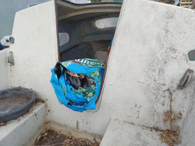

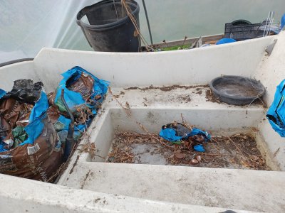

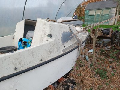

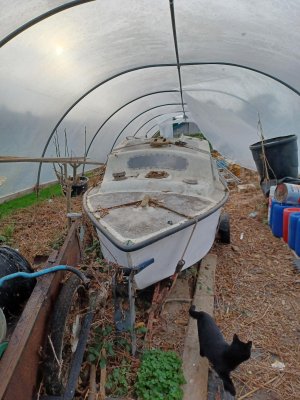

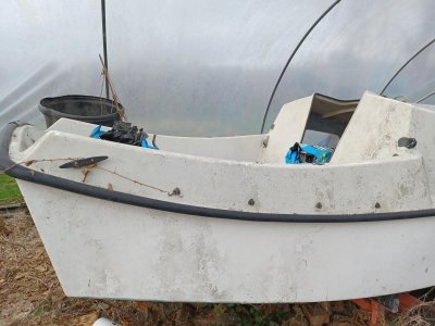

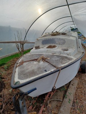

Hi there!

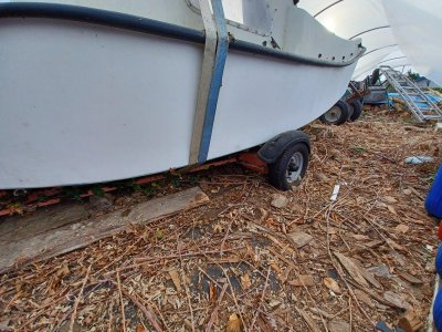

I'm collecting a Potter 15 on Thursday! It's been in a Polytunnel and unused for a few years, it will need a refurb! I've never taken on a boat refurb, am failry good at DIY, so I'm not daunted...yet!! Would love to hear any tips and suggestions!! My first job will be giving it a darn nice wash!!

collected today! Cut away it's encircling brambles and then we towed it out backwards woth a few joined ropes through a very long polytunnel, got the trailer tyres inflated, spun it around and huge delight when it was hitched on!!! Bit of heat in one tyre that I'm putting down to under-inflation but will test tomorrow and see if it's that or bearings! Trailer light board bought and a few bits and the money for old boat is certainly flowing!! Fun though!
