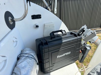

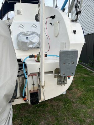

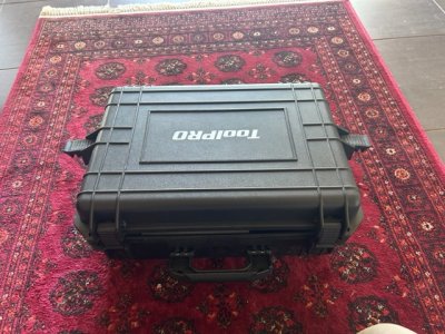

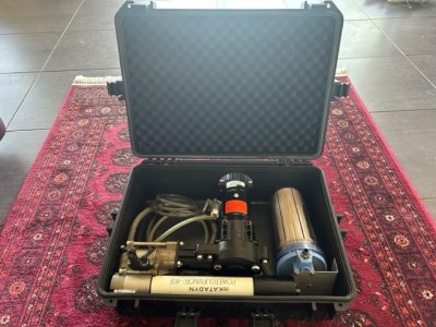

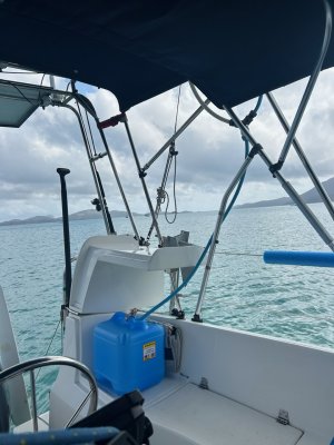

Just a couple of more bits to buy ( right angle threaded prefilter in and outlets) to finish this project of making a secondhand Katadyn power survivor 40e completely portable in a modified cheap pelican case knock off.
Whilst small suitcase sized it weighs well under 20kg cased with prefilter and fits in our stern generator box with room still for our smaller Honda eu10 generator but not quite our larger Honda eu 2.2 which we no longer carry due to up scaling our solar system. It will also fit in our cockpit and under settee berth lockers but the stern locker is more convenient and less stuffed already.
The eu10 generator is also virtually redundant now except for perhaps 3/4 days plus of very heavy overcast despite going electric for cooking, refrigeration, hot-water, torqeedo auxiliary and dingy outboard and other 240v occasional use appliances including air conditioning and electric heating in our 28 foot trailerable semi liveaboard yacht.
I am toying with leaving this generator behind as well having not started it on our last over two months out cruising.
The Katadyn RO watermaker is not high output at only 5-6 litres an hour but uses only about 4 amps at 12v which our system can easily provide by solar. 🙂

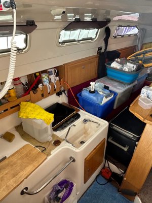

Our daily use is under 10 litres of fresh water due to extensive use of plumbed pressurised seawater and our fitted tankage is 140 litres. We however use an additional 4x15 litre portable plastic tanks in preference to fitted tank a bit taste tainted water and will desalinate into one or two of these which we also collect rain water into as shown below.
The galley picture also shows a 10 litre spring water container in use which was a once off luxury extra for my initially very taste and contamination sensitive previously non boating partner.
She is over that hurdle now and we have lived onboard for multiple months!🙂
The RO watermaker is to extend our time between needing resupply from 4-5 weeks to 3/4 months with water, wine and spirits being our previous constraints. For wine and spirits we will just have to carry more!😂

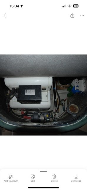

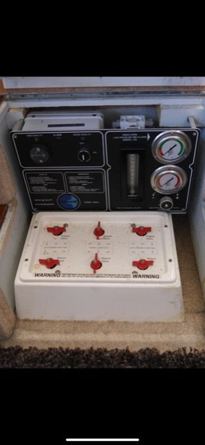

I’ll get the book next time I’m on the boat.
It consists a long thin tube. Maybe 1.5m long. Two filters that are the size of fuel filters (mobo not yacht!) Plus a pump and a control panel. It sits under a bunk in my boat and is lost in it.
Edit found pics.
Control panel
The red taps are my fuel stopcocks it’s the bit above that.
Under bunk.
Pump middle bottom
Filters blue on the right
Tube is the silver and black thing to the right of the generator.
The strainer is for the inlet water for the water maker.
