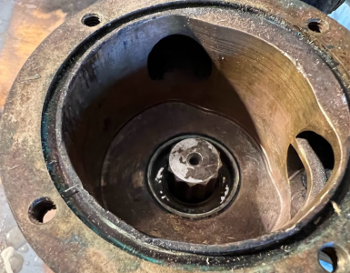

On getting the pump off, the impeller itself is actually quite mangled on its ends (so I am very glad I took it apart).
The inside of the pump feels quite smooth. Anyone had this before? I'm going to take the pump back to the bat cave and take it into its component peices, so I could do a rebuild for around £50, or get a whole new one for £300 and keep the old one as a spare.

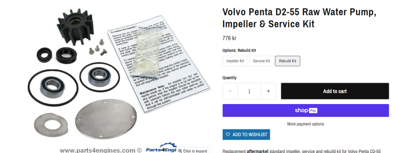

Rebuild kit:
Volvo Penta D2-55 Raw water pump impeller & service kits

I had meant to do a write up of this, and I will get around to it! It is one of those satisfying jobs you can take home from the boat and bash apart on your dining room table. I bought the rebuild kit from the fine people at parts4engines.
Volvo Penta D2-55 Raw Water Pump, Impeller & Service Kit

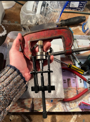

  • A smaller puller to split the bearings on the shaft itself.

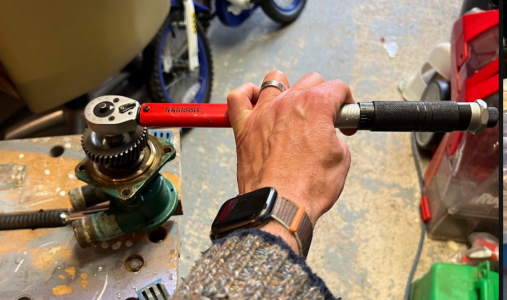

  • A big torque wrench to torque up the nut once I was in reassembly mode.

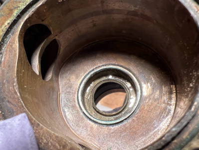

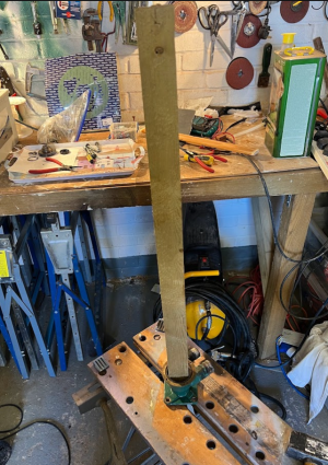

Driving the shaft out with a rather overlong piece of timber!

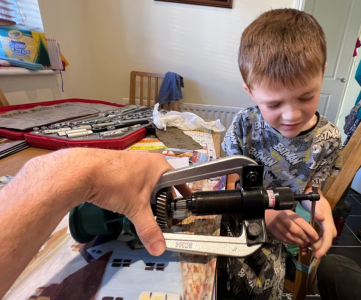

Splitting the bearings

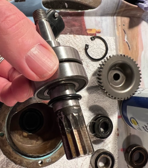

Tapping new bearings into place:

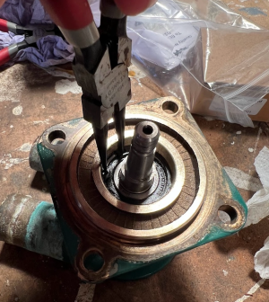

Circlip reinstallation:
Torquing the nut back up.
Good luck with the job!

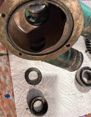

maybe add a pic or two with the seal on the shaft, to make sure none fits it the wrong way round with the spring getting in the seawater side like the idiot who rebuilt mine did last time! (different pump, but same logic/concept)

Fair point, so after the long piece of wood with the mallet had driven the shaft down, on the sea water side, we had the below:
Leaving the seal as below:
Which can then be gently levered out. Note the metal washer behind the seal.
Shaft ready for reinstallation. I'll try and find time to write up the whole thing. It really is a fun process the rebuild of the pump.
