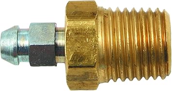

The inlet and outlet threads are M14 which are the same as my CAV filter. You will have to check your thread sizes as I believe that some CAV housings have a UNF thread which may mean changing your hose tails/banjo union.
