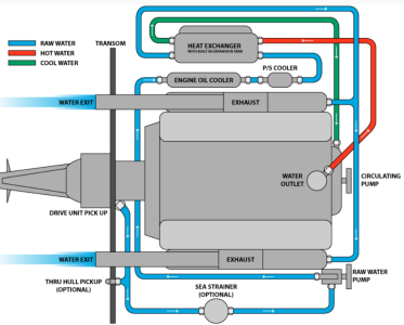

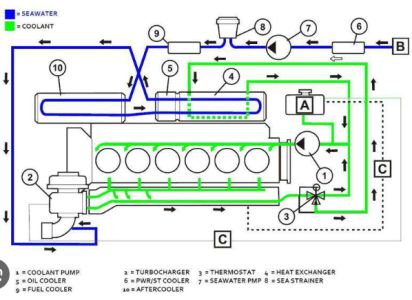

If going the fresh water cooling (FWC) route you buy a kit for the specific engine.
The water jacket surrounding the engine will be closed (as in a car) and circulating by the engine water pump, containing at all times an antifreeze mix of 50:50 (or as per the text on the can). Note that undiluted antifreeze will not provide antifreeze properties.
Seawater is then picked up and (by the raw water impeller pump) run through a strainer to the heat exchanger(s) (coolers) where it removes heat from the antifreeze and is sent out, mixed with the exhaust.
Since the sea water circuit has no thermostat or other tasks to do, it is straightforward to pour antifreeze mix into the strainer at idle until the leaving water shows the colour of the antifreeze (commonly done on the hard.)
Here is a so-called Half system, - Full systems include the manifolds into the engine water jacket as well:
ss2016
24 Jul 2016
143
Chrome Dome, I have long looked for a diagram like that. Thank you. I presume it is generic or was it a VP specific one? I have a D6-400 and it mostly applies but I would really like to find such a diagram for my engine. It's the charge air cooler I don't fully understand. One question, what is the 'P/S cooler'?
ChromeDome
25 Sep 2020
3,902
Generic it is.
P/S might be Power Steering

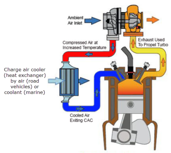

When the intake air is compressed by a compressor or turbo, it heats up. Hot air reduces the efficiency of the fuel, which is why it is cooled in an intercooler/intercooler (in principle just a radiator). On a boat, cooling is done by antifreeze, instead of passing wind (like on cars) that removes heat from the intake air.

A D6-400 without FWC. Really?
If you deduced that from my last reply we miscommunicated.
What I would really like to see is a VP diagram showing the complete flow of the fresh and salt water through the entire system INCLUDING the charge air cooler of a D6-400. I don't think it exists though.

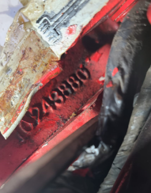

Update. Marine guy called today and stripped off the head for a look. Well cracked head... I attached the number I can see on the end of the block looks like 10243880 which I have heard the 880 also know as a vortex engine many times. Now need to research to see if I can get a long block... Thank you guys for all the help... will let you know how we get on..
