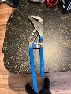

I can't say specifically for the TAMD41 but for me the following type has been the most successful for oil filters and for spin on type fuel filters .

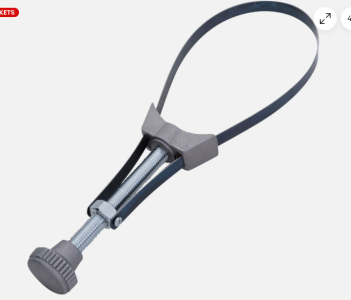

On that engine there is very little room to rotate a filter tool with an arm that sticks out within the length of the filter. This type works with a short 1/2inch extension then a ratchet drive.
https://www.halfords.com/tools/hand...d8APf57lTz0ihOrEQca70NzZEMkSm-ysaAmAtEALw_wcB
yeah those Sealey's look good but i was wondering about the access to rotate...
Will check out the chain & socket drive one (think i have a similar one in the shed left over from servicing my old Honda 20hp outboard a few years back).
