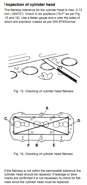

Head gasket.
The compression in the cylinders is much higher than the pressure in the cooling jacket. Hence prevent water from getting into the cylinders while pushing oil into the coolant.
I'd expect traces of water in the oil before long.
Edit:
As per Volvo's Workshop Manual:
So if the head is flat, you may get away with replacing the head gasket + whatever is detected during the work.
