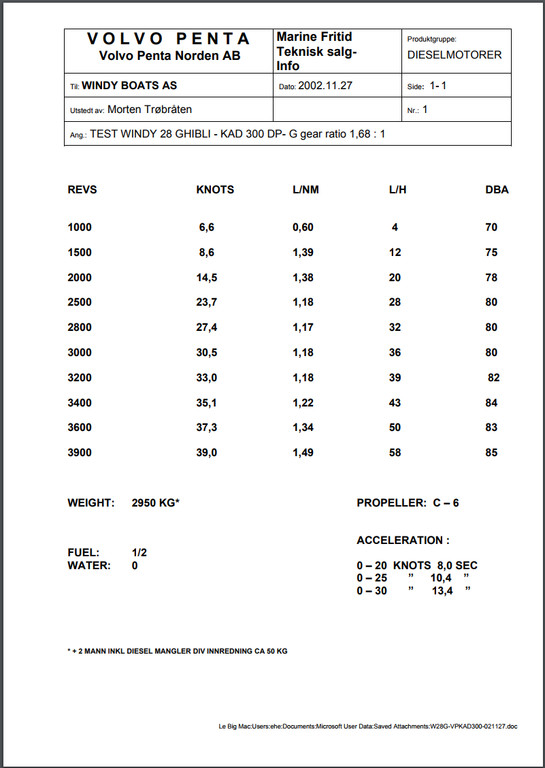

I'm struggling to find where I can find the correct fuel figures for this engine can anybody point me in the right direction? There must be some some sort of chart that gives fuel consumption at different rpm available?
The boat is a Prestige 32 with twin Volvo KAMD 300 (285hp) I'm guessing it will be around 65ltrs per hr at mid level RPM say between 2300 - 3100 but I would like to see some official figures from either Volvo or Prestige Boats but can not find either? Help!!
Single engine, outdrive KAD300, and not the same boat, but the figures will be similar for any particular RPM.
With two engines:
- 2800rpm = 64L/hr
- 3000rpm = 72L/hr
MBM. The mag used to sell boat reviews .
I bought £ 7 one of the Portofino 35 Vs Sealine S 38 , they had KAD 300 ,s
Included is the performance chart as above ,I remember 35-40 L/h per side therefore 70-80 L/h cruise at 3-3100 rpm .
You could see if they ever tested the J 32 and buy the review .
J 32 is couple of tonnes lighter so I would have thought the L/h maybe a bit less nearer 70 @ 3-3100 rpm ? Perhaps a few L less ? High sixties or so .
Weight and sea state play a part too .
