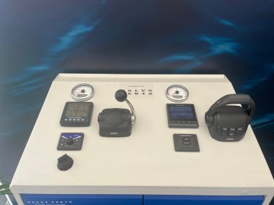

It’s worth stopping by the VP stand if you are going to the show as there is a display at the back of the stand for the upgrade kit, albeit in single engine form.
As attached, old kit on the left, equivalent upgrade kit on the right.
You don’t have to have Glass Cockpit, it’s just if you were looking for it then EVC-E is the minimum level you’d need to support it. There are other smaller display options, and yes, it’s more cost than just a single control unit but for what you get in the kit, the pricing really isn’t too bad if you compared it to buying the component parts of the kit separately.
