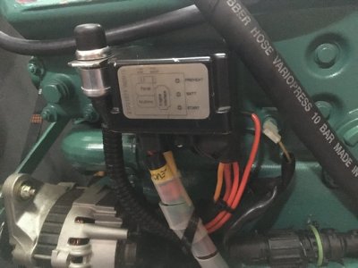

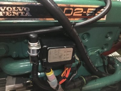

I have a D2-55F and although the MDI has never given any problems, I fitted a heavy duty 12V push switch to enable starting if the MDI fails.
I have purchased a push button for a byepass switch to start the engine in event of MD1 failure. However, I am not sure where exactly to fit the 2 wires.
Can anyone describe EXACTLY which terminal on the md1 unit I should connect to & where the other wire should go please
Thx
You just need to connect the battery +ve terminal on the MDI to the start terminal on the MDI through the switch. The switch and wiring need to be heavy duty to take the starter current. I didn’t bother connecting the “preheat” terminal for the glow plugs as my engine never needs preheat here in Portugal.

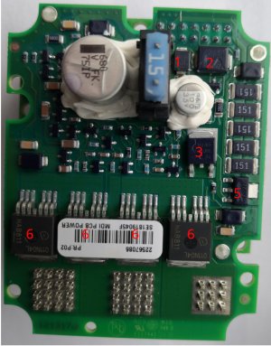

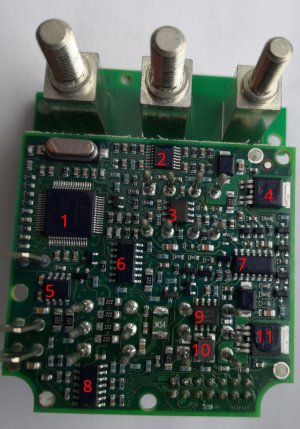

Unless your MDI-box has been sitting on the shelf for quite a while before being out into your boat, its PCBs should have looked like on the attached photos.
PCB 1:
1 LPC2119FBD64 NXP LPC2119 µC with CAN
2 HC4052 RT65711 TXD17 27E 74HC4052 4-Channel Analog Multiplexer/Demultiplexer
3 2904 SA6U (oder SAGU) LM2904 OpAmp
4 6163D Infineon PROFET® BTS 6163 D, High Side Power Switch
5 24C01CI SN1608 MCP I2C EEPROM
6 2901 ST MZRR737 STM LM2901 4x Comparator
7 NCV4269A5G ON PPJJ11 OnSemi NCV4269A Low Dropout Regulator, 5V, 3,3V 150mA
8 2901 ST MZRR737 STM LM2901 4x Comparator
9 NXP A1040/C AWW000 nD744 NXP TJA1040 CAN Transceiver
10 EPCOS C104 7405 39
11 6163D Infineon PROFET® BTS 6163 D, High Side Power Switch
PCB 2:
1 ST G EXY Z731
2 ST G MIMY ???
3 12CWQ04FN V P639G Vishay 12CWQ04FN, 2x Schottky, 2x 6A
5 W77 /16 BCP53 BCP53 PNP Transistor
6 011N04L Infineon IPB011N04L N-Channel Power MOSFET, 180A
So the stop solenoid is switched by an Infineon PROFET® BTS 6163 D, datasheet is here. This is not just a simple MOSFET - and I do not think it is easily killed. In fact, it was a smart move to get rid of the relays. Relays are sensitive to vibrations, and some genius decided to bolt the MDI-box onto the engine...
Which raises the following questions:
- What were the error symptoms with your 3 MDI-boxes?
- Did you have a look at the PCB? Are you sure it was the PROFET switch?
- Do you still have one of the MDIs?
Perhaps there was a common root cause for the failure of your first three boxes, and that root cause is still waiting to knock out your fourth, too.
There are 3 main terminals on the underside of the MD1- How do I know which 2 they are please?
I have a 2023 engine, imported just as I bought it from Volspec, so latest offering.
May I also ask- Am I not just energising the solenoid. So wires do not need to be excessively big.
Symptoms - revs start hunting down to idle and back, and the stop button stops working. It never cut completely. Sometimes the on or start button refuses to work, but it's intermittent. Box replaced under warranty - no further problems, touch wood.
Yes, the switch is just energising the solenoid so no huge cables needed. I think the middle terminal is battery +ve (red) and the red/yellow wire is to the solenoid but check the schematic on the side of the MDI and it’s obvious which is which.

Button problems can be caused by
- the panel or cabling,
- cold contacts around one of the comparators (6) on PCB 1, or the LPC itself,
- a broken MLCC at the input to the comparator. This was the issue in my case. An easy fix for about 0.01€.
PCB 1:
PCB 2:
1 ST G EXY Z731
2 ST G MIMY ???
