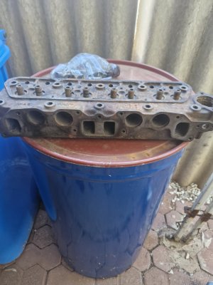

DBAdel
1 Feb 2024
9
Those are car heads they have different thermostat housing, and modifications need doing to convert. This is my old one. You'll see the differences kashurst. Cheers for you taking the interest o help.
DBAdel
1 Feb 2024
9
Thank you for you taking the interest to help. Unfortunately only Volvo Penta AQ130 B18 or B20 fit. The head that was recently on was a B18 head which fits and matches perfectly, same pushrods, stud bolt holes, just valve ports cups smaller and it just makes a higher compression motor. Because my previous B20 head 10 years ago, was toast.
