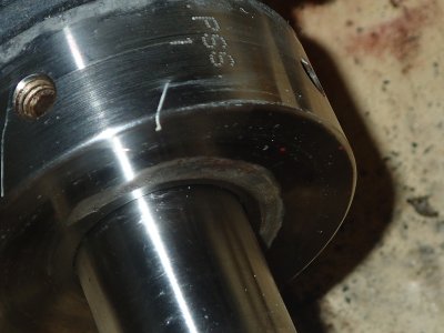

I am not quite sure when I fitted my PSS, although I know it was installed prior to 2008. Probably 2007 in Greece. The boat has been used for six months of almost every year since then, engine hours estimated 2500, wintered ashore. The PSS has had one problem: the stainless steel rotor face suffered a little contact corrosion over the winter in 2014 and had to be reversed. There is a ground face on each side of the rotor that allows for this. Since then I have flushed it with fresh water at haul-out and wetted the faces before launch. No further problems.
Other than that it has never needed to be maintained in any way. Still on the original bellows that remain in good condition with plenty of spring remaining. An utterly reliable bit of kit.
