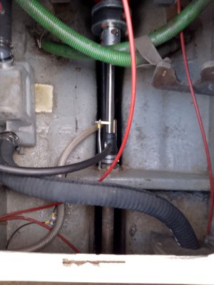

Shaft whip is a function of length of unsupported shaft in relation to diameter. You don't say what the shaft length is nor whether there is an intermediate bearing in the stern tube. Generally speaking the R&D is not very "flexible" and in many boats there is no problem with using a Volvo seal if the shaft is short. In my new installation, because the shaft is "long" (54" from memory 30mm) I chose a better flexible coupling (Bullflex) and put an intermediate bearing in the inboard end of the stern tube, then used a Radice Volvo type seal. So more information needed on the shaft length and position of any bearings. The Volvo recommendation assumes long shafts with only one bearing, usually in a P bracket.
If a Volvo seal does seem impractical then the best alternative is a Tides Marine Sureseal which has lip seals like a Volvo but mounted on a flexible bellows like a stuffing box you French source referred to. Proper well engineered job with replaceable seals should they ever wear out (unlikely!) shaft-seals.co.uk/product/propeller-shaft-seals-sure-seal/

I think the alignment bearing is part of the housing for the seals and is there to keep the shaft concentric with the housing and the lip seals. This performs a similar function to the back part of the Volvo seal which is a fluted water lubricated rubber bearing. The whole assembly is flexibly mounted to the stern tube. It may not be possible to insert an additional bearing in the stern tube. A common arrangement with a P bracket is to use a short plain tube glassed into the hull, maybe 40-45mm ID with an OD of 48 or 54mm to take the Volvo seal. If it is 54mm there would be just enough room to bore it out to take a cutless bearing (these are available with either 1 7/8" or 50mm OD shells) but whether it is feasible to do this in situ not so sure. On my boat we used the old stuffing box housing. As you can see from the photo it just fits with a 3mm wall thickness (30mm shaft but principles the same. Of course all this comes apart and the housing was bored on a lathe. This is the second one I have done like this. You can see the Bullflex and the complete seal arrangement in the second photo
Hope this helps
