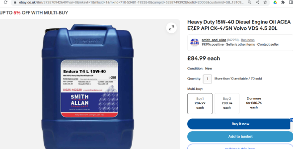

this is the first service for us on this boat (2015 Sealine S380). for the last 10 years have had D4 engines and it was always VDS3. Engineer said to get VDS4.5 mineral oil for this one, but doing some research it looks as if it is no problem to change to synthetic and there are plenty of suppliers available. The only mineral oil seemed to be Shell Rimula RT4L - the T being the important letter..
ozzie
9 Mar 2008
187
bristol
I went for the Smith and Allan Endura T4L ordered direct. They had a 10% discount code so bought 40 litres for £139.44 with delivery!
